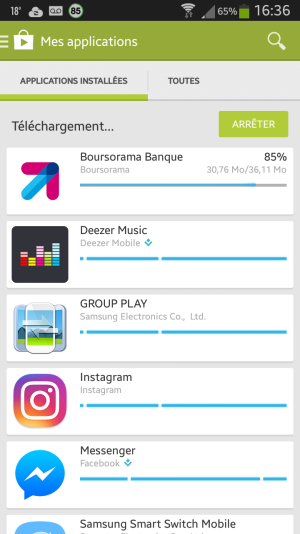

Hi,
I cannot update my apps.
It starts to be downloaded and it is blocked at a percentage, always the same for one app, and nothing happens.
I cleaned the cache, restarted the phone.
I disconnected my account and reconnected
I stopped and cleaned fthe framework thing
Same problem in data and wifi
My phone is a Galaxy S3 with 4.3 version.
What can I do?

It doesn't work.
Sometimes I don't know why after 2 days more or less, the app can be installed.
Sometimes the app is shown as 100% uploaded but nothing happens.
Sometimes, most of the cases, it's like this, %age remains the same, even after stopping this particular app upload, and starting again.

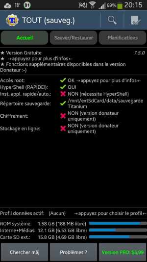

Sorry, I'm not sure about that screenshot.
You mentioned that this happens on mobile data and wi-fi. Does it happen on any wi-fi network you try, or have you only tried your home network?

Sorry for the confusion, this screenshot is to show the availability inside my mobile, in case it can influence the issue.
Did I mentionned I have the same issue with my Galaxy tab+ tablet with androïd 4.2?
Yes it happens in wifi and data mode.
I'm not sure but I believe it happens whatever the wifi router is.

All the apps, small and large, updates and new ones
Often it stops to be downloaded at the same percentage, app A at x%, app B at y%
I remove these download jobs, boot again initiate again the download and the jobs loop: app A at x%, app B at y%
