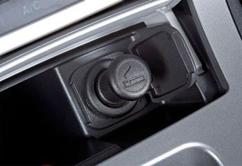

I wonder why you want to use this air purifier inside your car ? You can use just an air freshener right ? You can try plugging it to the cigarette lighter port. Maybe it would work ...not sure.
There is no reason why you can't as long as the 12v outlet can coupe
In the past they were know as cigarette lighter sockets and had a 20 amp rated fuse
Now your lucky if there 5 amp so that needs checking
Well I have severe wheezing problem so I cannot use just some air fresher or something very cosmetic so I wanted to specifically use this air purifier because these are the only things which can help me cope. Cigarette lighter port ? How?

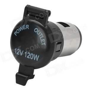

Now Most Cars Have a 12V outlet or What they were Known a A Cigarette Lighter socket
Now there
The sockets are Rated at MAX 24 Amps on 12Volts
Now if you havent got one of these Outlets you need a Auto Electrition to wire one up fo you
Thanks a ton . I have this socket in my car. My friend lent me an inverter to test and it. I used the inverter to connect the air purifier to the socket and it seems to work just fine. I had no idea it was this easy .
If you see now you have the socket a Auto Electrition you may not need the inverter Just a Plug to go into the socket of the car and a plug to go into the Air purifyer. But at least you no it works :)
