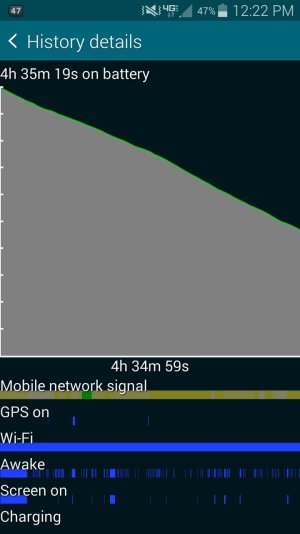

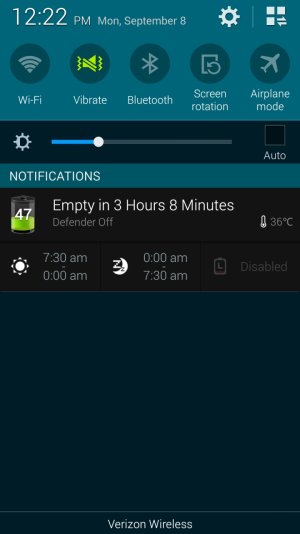

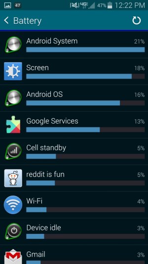

EDIT: Images below! These are for today with my battery going from 100% to 50% in only a few hours, with very minimal use (except for a while in the morning and sporadic checking of my phone otherwise).
Also, I don't know why WIFI shows as being on the entire time. I turned it off hours ago.

Updated with photos from today! I'm only down to 50%, but I think this should show the issues pretty well.
You've got serious wake lock issues by the looks of that graph. Definitely clear the cache partition of your device and do a battery pull too. That should greatly help your battery. And if that doesn't work then try using the phone in Safe Mode for a while. See how fast the battery discharges on standby then and compare it to your regular stats. If it works good In safe mode then yo probably have a rogue application that's taxing the CPU and preventing it from going into deep sleep.

I am noticing that OP is getting very low signals for 4G, if the networks swaps between 4g/3g/2g continuously then it causes serious issues of battery. Check what kind of signals are you receiving at the place you stay and use accordingly. All the pics shows you are on 4G with low signals, that might be the reason. If you can get 3G use on it and revert us.
