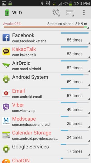

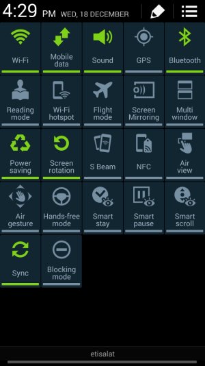

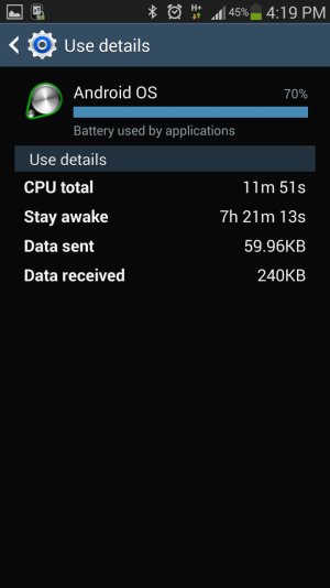

Hello all,
I've been using my S4 without any battery drainage problem for many months now. Things have changed in the last few days with very unusual drainage. It seems that my phone never sleeps. I tried to understand the problem, using GSam and Wakelock detector but can't get to the root of the problem. I very much appreciate your input.
Have been using the same settings for months with bluetooth on without any problem.

Thanks all for your input...I managed to figure out what was going on..My wifi was always on and I'm aware that this can affect the battery when the signal is not strong but never imagined it can have such a detrimental effect. Here is the result with the wifi off..as its very poor at my office.
