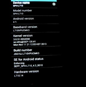

My S3 can boot normally to the rooted OS, or to "Download Mode" but seemingly refuses to boot to recovery mode.
For some reason, it will not accept the [volumeUP/Home/Power] combo (even though ti did earlier to root it to start with)
[all the buttons work fine when I use them in regular mode)
I've tried several times, but all it does is vibrate quickly with nothing displayed, then when I let go of the three buttons (I can wait one second or thirty, it doesn't matter) it seems to go back to standard booting and boots to the OS.
Again, it WILL boot to Download Mode.
It will NOT boot to Recovery Mode when proper buttons are pushed, and simply boots to the main OS after I let go of the buttons.PhoneStats.jpg.
Here's the specs:
model: SPH-L710
Build: JSS15J.L710VPUCMK3
Android 4.3 (OTA'd by accident).
Running rooted (via Odin) but not ROM flashed.
