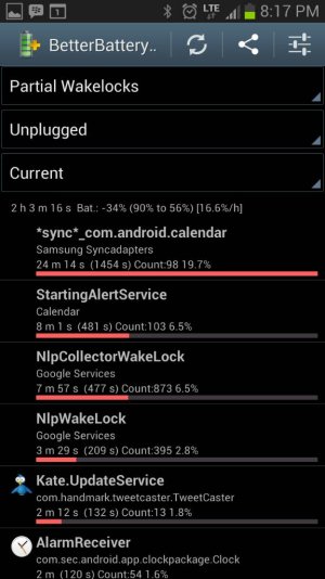

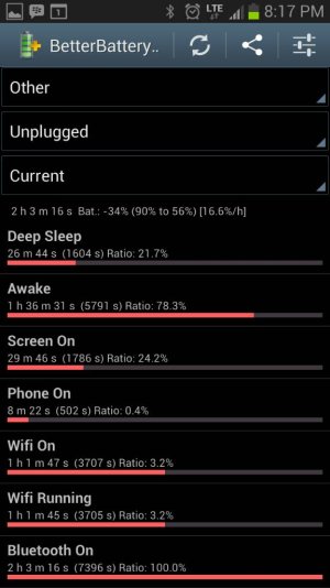

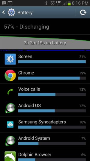

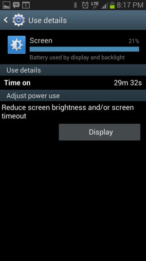

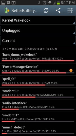

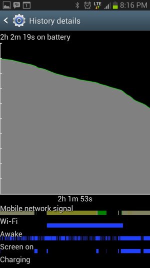

I have been having poor battery life and I don't know how to fix it. The phone doesn't last 9h on a single charge. Here is a few screenshots:

The second-to-the-last screenshot certainly shows some unusual Awake events that do not correspond to Screen On events.
And you're on Mobile data rather than Wi-Fi, so that's going to chew up additional power (unfortunately none of the information shown indicates what kind of LTE signal you had).
And as the previous poster noted, your dataset doesn't start at 100% and doesn't run down far enough.
I'm not sure why Samsung Syncadapters is listed for calendar events, but that's a pretty big chunk of wake events.
