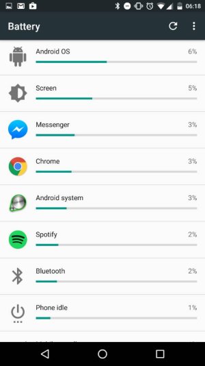

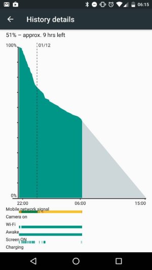

So I set my phone down at 1am when I went to bed. It was at 65% battery. When I woke up 5 hours later, 53%. This seems poor to me. Any tips?

I've found that occasionally apps keep a phone from properly dozing.
The trick is to find it and shame it into compliance.

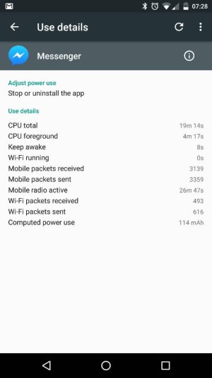

I can see a couple of things in your battery stats. You had a poor cell signal and usually this will drain your battery faster. Also, some app is keeping your phone awake all the time (your awake bar is solid). You should check which app is causing this. Seeing your list I would start with Facebook Messenger.
