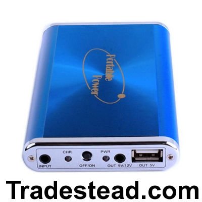

Perhaps you're looking for something like this?
5200mAh USB Portable Power/Battery/Adapter for Mobile Phone/MP3/iPhone/PDA/Digital Cam etc - Electronic Devices Battery Pack products, buy 5200mAh USB Portable Power/Battery/Adapter for Mobile Phone/MP3/iPhone/PDA/Digital Cam etc - Electronic Devices
