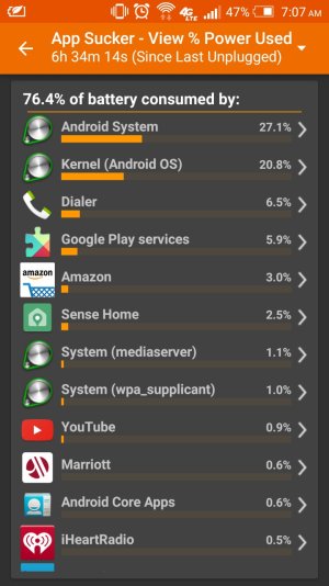

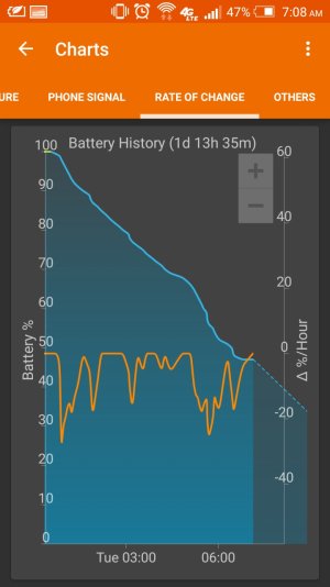

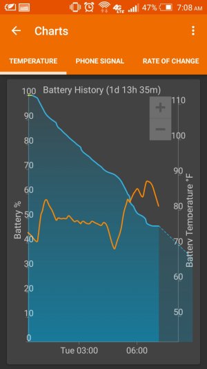

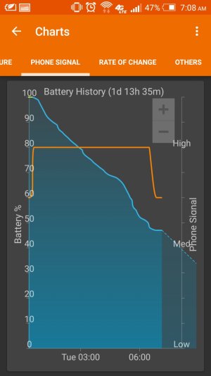

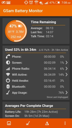

Has anyone that updated their M7 to Lollipop and have it significantly impact their battery life. My AT&T M7 was going strong until I updated, but since then, it dies quickly even when the phone was off. I tried to recalibrate the battery by holding the volume keys and power button while it flashed on and off for a few minutes like I saw on another thread last night. I then let the phone charge to 100% at about midnight last night and unplugged it and just let it sit there. This morning, it had drained over 50% in 7 hours of no use. Here are the screenshots of the battery stats. Does anyone have any tips on what is going on?

Mine is awful after the update. 100% in the morning. If I let it sit idle, no use, its down to 80% by 9am.
Full charge at 6am, with moderate use, I'm down to 40% by 10am.
Before the update, with same usage, I wouldn't hit 40% until 5pm, if not later.
The other issue I have, is once I hot 20% battery life, I can literally watch my battery drain. From 20% to zero is about 15 minutes.
Awful
I just did a factory reset and it seems to have fixed the issue. Only lost 5% battery life last night while I slept.
My Nexus 7 had the same problem until 5.1 came out. Seems that a memory leak causes battery drain and slows down the phone. So if HTC doesn't plan on a 5.1 update the problem won't go away.
