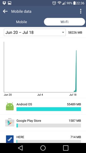

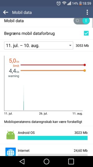

I need your help. My recent upgrade from LG G2 to LG G4 has not turned out the way I hoped. During the past week my phone has burned up 5 GB + 2 GB carrier mobile data. And this data is reported used by the process "Android OS". The phone is eating my data package and I am not able to find out why/how, since "Android OS" gives no further details in the mobile data overview in Android settings.
LG asked me to reset the phone and contact my carrier to know the type of data I am consuming. I did a factory reset and manually installed my apps afterwards. I also checked the settings section of each app looking especially at sync + mobile data options. Then I called my carrier, who said that they only track monthly totals = no help.
Unfortunately the problem did not go away. Since my yesterday evening wipe my phone has burned another 2 GB data even though I have been on wifi most of the time and mobile data has been disabled from the "roll down curtain" during the night.
Update - My phone also used 60 GB of Wifi in 25 hours

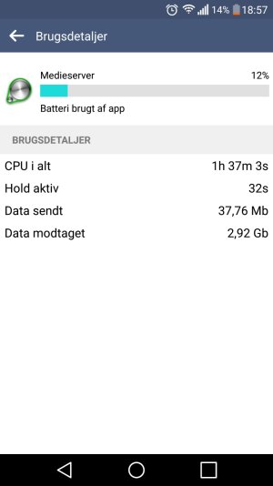

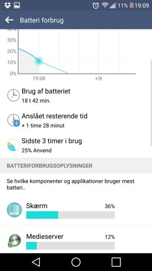

Based on my own first question, I just looked into my battery overview :-)
Sorry for the Danish Language guys, but please see the screenshots below. Do you agree that something is very wrong. I am at the office and my phone is connected to WIFI. I just charged the phone a bit a few hours back.
In the battery overview the process Mediaserver has used 12 % of my Battery.
If I click the process, Android shows me that since my phone was lightly charged 2 hours ago, this process has uploaded 37 MB and downloaded almost 3 GB data.

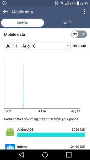

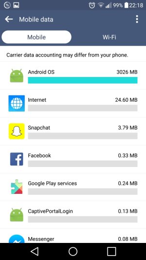

If I look at the mobile data overview it shows me 3 GB of data has been used by Android OS (Remember I wiped the phone last night)
Would you agree on this interpretation:
I have been in my office all afternoon with wifi enabled on the phone (my pc has streamed Tour de France, hence no drops in Internet :-). Still it seems that my phone has burned 3 GB of MOBILE data in the background through the process Android OS - Mediaserver.
I dont need to worry anymore because my extra purchased data plan has been used up and I am now blocked by my carrier.
Jesus christ. What can I do? It is not easy to test, since every test will cost me 10 dollars for an extra data package from my carrier.
Aha, based on that I bet you need to change your Media Server settings. Settings -> Wireless Networks -> Share & connect -> Media server. What do your settings look like? I have "Content sharing" off, and I'm wondering if you have it turned on.

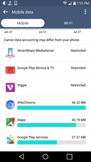

Have you restricted background data from any apps to see if it stops the use? You can't do anything with Android OS specifically but you can restrict other Google apps that may actually be the problem.
Hi Tourbound129,
Thanks for your comments. What would be the strategy for restricting background usage. Just do it for all apps? My challenge is that testing will cost me a 10 dollar data package :-)
Since the wipe yesterday only few apps have made it to the mobile data list
Screenshot_2015-07-18-22-19-45.jpgScreenshot_2015-07-18-22-18-53.jpgScreenshot_2015-07-18-22-26-18.jpg

Hi David,
Sync would also be my idea, since the amount of data is insanely high. My phone has used 3 GB mobile data and 58 GB Wifi data. In 24 hours!
But where to start. I use Dropbox. I dont use other clous service, but I am unsure how to know whether I am using Google Services (think I tried Music once). Any ideas?
Since the phone is recently reset, there shouldn't be 60 GB of data to sync from the phone to some cloud service. Hence I guess it ought to be download, or? My storage shows 19 GB used of 32 GB. Where is all this data going?

Hi Tourbound129,
View attachment 187595View attachment 187594View attachment 187596
Well restricting mobile background data won't increase data consumption only decrease it. Doesn't look like you have any app issues but sometimes Android OS can be a catch all for some of the Google services.
I've seen no negatives to having background data off on the apps I use.

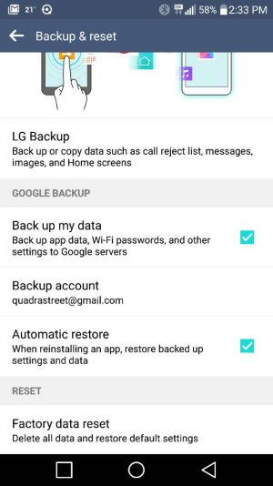

Have you seen this thread? CANNOT REPOST URL For those folks Google Backup was the culprit.
Thanks for the link. I did see the thread. Unfortunatelly, it did not help me. Since my wipe 24 h ago I have had the Backup and Reset - Back up my data to Google Servers disabled.
The thread dates back a few years and the users report up to 1 GB of data. Some users in the thread are noting that Youtube data counts as Andriod OS. I didn't use youtube for the previous 24 hours since the wipe and my phone is reporting 60 GB on WIFI and 3 GB on Mobile. Which would equal a crazy amount of HD streaming (say 3 full Bluray quality movie streams).
