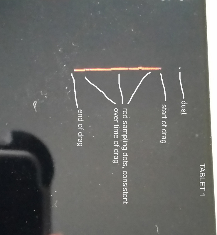

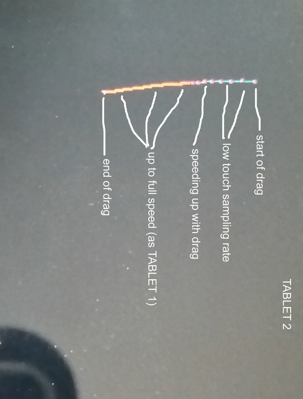

I bought a pair of Galaxy Tab A (8 in), new, from Costco. First was bought a few months ago, second a couple of days ago. Both are running Android 10, both report same manufacturing location (China) and year (2019).
The issue:
One and only one of them has an odd performance problem that I almost-remember reading about somewhere a while back, maybe regarding an optimization or something related. I'm hoping someone else might remember same or know the solution.
System caches have been flushed. Any other apps are shared on both. Restarts, "optimize", etc., it's all been done. In Developer options, I enabled "Pointer Location" to demonstrate what's happening. Please see pics.
On both tablets, I performed a simple slow touch then swipe right to left. The result is completely repeatable and consistent, so it's not a variation in my touch. The first pic, from the first purchase, shows a steady almost continuous red line made from dots indicating the motion and sampling thereof. The second pic, from the second purchase, shows the problem clearly: the touch is met with a low sampling rate period that then "ramps up" to match what it should be (and is on the other tablet). I am guessing this is some sort of optimization, but who knows. Apparently the hardware and software (assuming no defects) are not the issue, as the tablets are otherwise identical. So maybe it's a setting that can be changed.
This performance issue shows readily in anything from scrolling home pages (I did try tweaking the suggested options regarding this; it had no benefit) up to Minecraft -- which otherwise runs great, but when press-and-holding to mine, then turning to move to another block, the second tablet chugs like no one's business.
Sorry about posting pics this way; this particular form didn't appear to support any other method.
First tablet
https://i.postimg.cc/V6gsdW8k/20210610-091737.jpg
Second tablet (with problem)
https://i.postimg.cc/52Bh4N1x/20210610-092020.jpg
Hi, thanks. At present, that's not something I'm able to do. However, the pics do show what's happening (make sure you're viewing at full size): in the first, the line of red dots is continuous, high rate, no interruption. In the second, the dots (moving right to left, constant speed) start out spaced far apart, suggesting they are being read or sampled at a very low rate, almost like an optimization maybe trying to save battery power or avoid errant clicks. As I drag left over the course of a second or two, the dots increase in frequency, until finally, they become a steady red line like the dots in the first pic/first tablet. Here are two zoomed-in and annotated crops. Those early low sampled bits make a huge difference in usability of the tablet.
First tablet
https://i.postimg.cc/q7ysbTgS/20210610-091737ed.jpg
Second tablet
https://i.postimg.cc/m21tNSP6/20210610-092020ed.jpg
