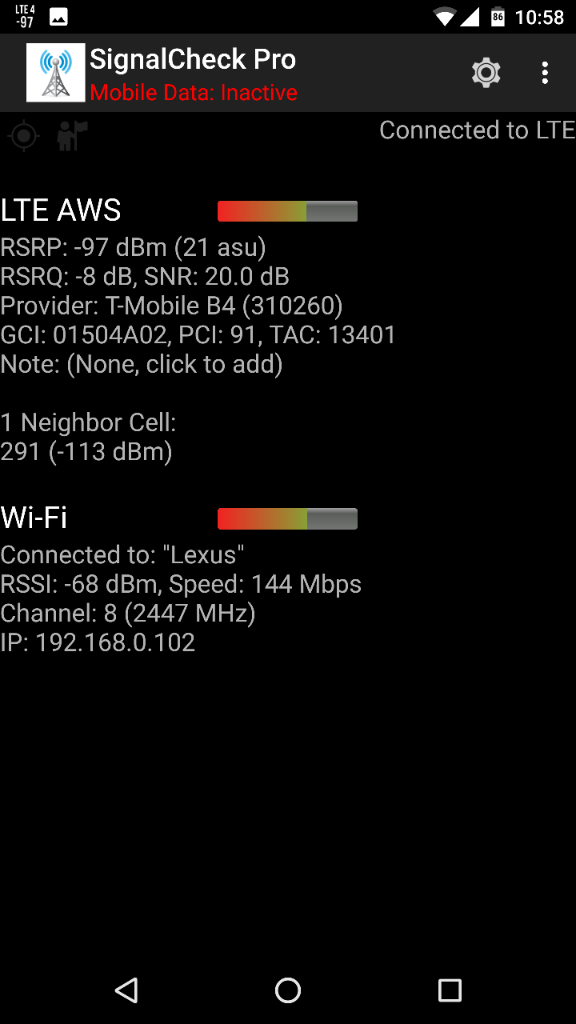

You could use an app like SignalCheck Pro https://forums.androidcentral.com/e...ls?id=com.blueline.signalcheck&token=a-5EZ4Jw (there's also a free version) to check your signal at the time the problem occurs.

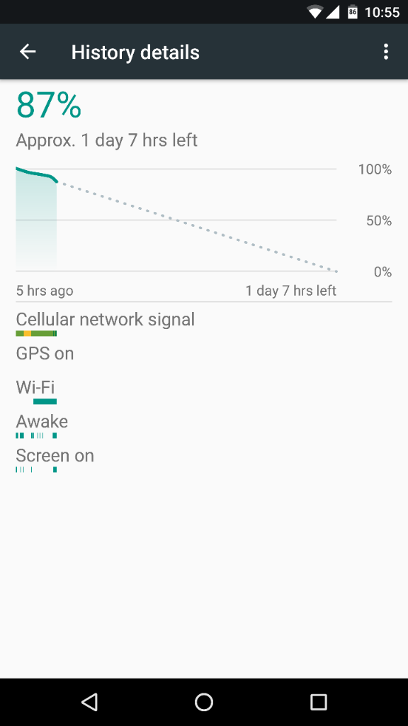

You could also use Settings -> Battery -> History details (touch the graph to see this view) to look at your overall cellular signal.

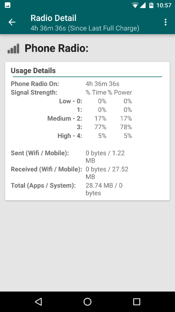

Or you could use an app like GSam Battery Monitor Pro https://forums.androidcentral.com/e...etails?id=com.gsamlabs.bbm.pro&token=Q4GXNRdW (there's also a free version) to get a more granular breakdown of your signal quality.
