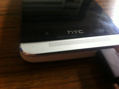

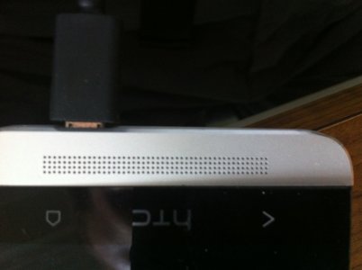

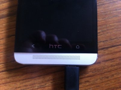

I'm new to these forums but feel compelled to share with you all that my HTC One (M7) has devolved into a useless form only 14 months of light use (no rain, no major shock, just in my back pocket).
While it was an enticing purchase when I bought it due to its sleek, elegant design and aluminum pack panel, the product itself is of laughably low quality. I knew upon receiving it and noticing the misaligned speaker holes, panel gaps at the top and bottom, and a screen that was not manufactured flush on the phone surface that this might turn into a rough ride. I spoke with reps when I received the phone and they told me not to be alarmed. However, after 14 months of normal use, my phone dies after about 15 seconds of use and the adhesive holding my screen to the body has come undone so that now there's massive gap underneath it. This is perhaps due to the incredible heat emitted by the phone when I use certain apps like navigation.
Basically, sure the phone looks great and contains competitive hardware. But what really matters is reliability and reasonable build quality. The HTC One exhibits neither of those qualities, and I therefore highly recommend that any of you considering a new phone look into the Samsung S5, iPhone 5S, LG G3, etc.
I do not anticipate purchasing another HTC product again unless they improve themselves!
Disclaimer: I am an engineering student at MIT and am in no way partial to any other brand of smartphone. I am currently using my old backup iPhone 4, which is functioning just fine and dandy :)

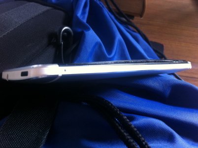

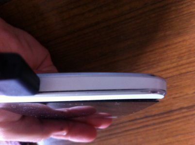

By the look of the second to last picture, I dont think the screen is bad, I think the frame is bent.
Idk man mine looks mint since launch day I've dropped several time and even accidentally kicked my phone. I use a cheap super thin tpu case and my phone looks mint.
Those pictures look like maybe someone sat on the phone or maybe it was sitting in the sun and melted idk. I've never seen one in such bad shape and I have a few friends with HTC one m7s.
The frame is probably bent because the OP keeps the phone in the back pocket. When you sit on the phone and don't take care of it then this is what happens. I have had my One M7 since October 2013 and it still looks brand new. No problems at all. But then again I take care of my phone.

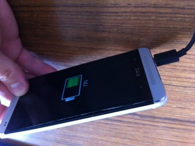

I think what really happened is the OP has a unit with a bad battery.
With him mentioning the phone dying after 15 seconds of use, plus the fact that the screen is bowing out like that makes me think of a battery pack going bad and releasing gasses. This causes the sealed batter pack to swell up. I have seen this happen on numerous blackberry, motorola and iPhones.
I have actually seen an iPhone 4 and 4s have the screen pushed out and the battery door broken off because of the battery pack going bad and swelling up. I also have some of these batteries at my office. (i work in the smart phone repair field so i have seen this before)
This in my opinion has nothing to do with poor build quality. Its like what the fire dept uses for rescues. They take giant air bags and inflate them to lift heavy objects. In this case the gasses forming in the battery pack have found the weakest point. It very well cant break through the aluminum so its pushing the glass off where the adhesive is the weakest.
Heat is one of the worst things for Lion packs. That and letting the battery voltage get to low. It will speed up the break down process inside the battery pack.

@IAmSixNine actually had some useful information to share and I agree that based on the presented problems the issue is most likely with the battery that HTC used, not with the device itself.

Hey guys, thanks for the replies and sorry for the delay in responding. I've been busy with school stuff, and as I mentioned in my original post, I don't check these forums often. Also, I did post the same pictures other places and erased their content because they were apparently in the wrong location, e.g. the new HTC thread. I didn't, however, delete the entire posts because I couldn't figure out how to do that :/
It seems these problems with my phone were anomalies (at least hopefully) given the number of you who were outraged by the pictures. Well, unfortunately, this is not a joke and actually happened! I sent the phone back to HTC, and according to their tracking page it seems they've repaired the phone and are sending it back to me with no charges mentioned! Let's hope that's indeed the case--I'll let you know what it looks like when I get it back: pictures and all.
