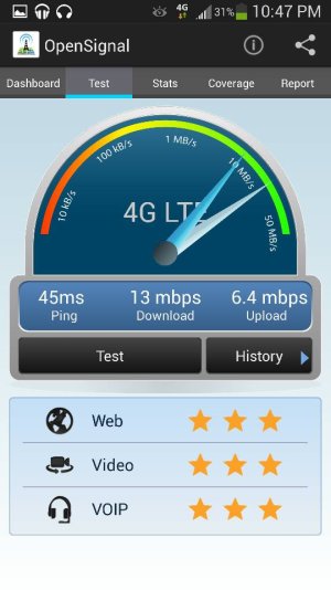

Mine got 4G right away after they fixed the problem!
I was calling from a landline and as soon as I put my SIM card and battery in and turned the phone on, walla! I can see 4G on my phone!
Now of course I was inside a 4G coverage area.
