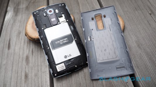

Well I gave it a shot. Several weeks of delivery time though. So it says remove the original NFC ic chip firstly from the slot of the battery back cover. Can someone show me on the attached pic what this chip is that needs to be removed? Do I just pry it off? I wonder if it can be put back just in case?

I cannot guarantee this but on my G3, the part you swap is on the cove. It is under that black sticker. You would peel that off and and the new one should have come with an adhesive strip to apply the coil, the coil and a similar sticker to cover those items. The exposed contacts under the cover would then line up with the new sticker on the cover.
** edit **
Yes, if you look at the aliexpress page one of the pictures shows the new sticker on the back cover as i described.
Would this chip work with both the leather and plastic backs ? Would replacing the chip kill the NFC ?
Roger
Should work with both. The chip should have Qi AND NFC, so you shouldn't lose NFC functions. I've got mine ordered but it will likely be a few weeks...
