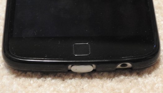

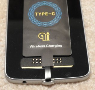

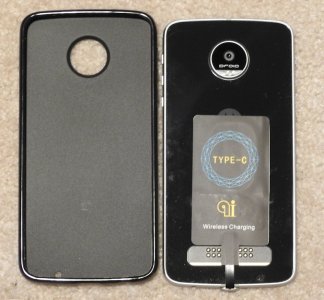

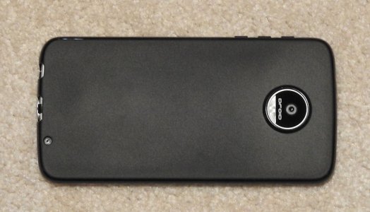

Here are images - should be self explanatory.
Final look (back).
Separate back + installed "antenna"
Installed "antenna" - close-up
Front view on USB port with antenna
Front view on USB port with antenna + back installed
