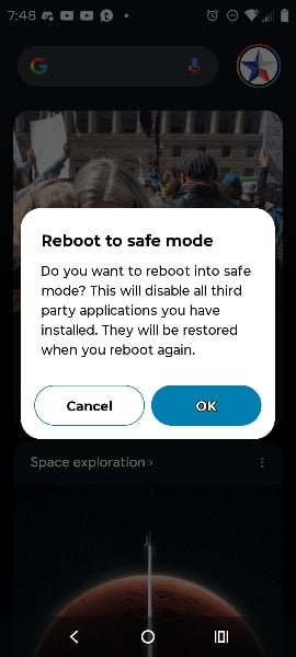

***B. Diddy... To get to the screen shot attached, I have to hit the volume up button with the power button. If I then hit the power button, or first hit the power button, I get the voice search pop-up. I can't get to the safe mode choice.
**Wait before you post any help. Without the widgets added back, the search function quit again. I deleted cache and data again and want to see how long it takes to stop working. I'll post back later
When I hold the power button down the screenshot below comes up. If I hold the power button down, it restarts, holding the volume down button does nothing. A search said to wait till the restart initiates and hold the power and bill volume down together. I get a choices screen with a little Android man. But, no safe mode

In that screenshot, what happens if you long-press the Power Off onscreen button? (The Power Off button referred to in the steps are the onscreen button, not the physical button.)
I'm sorry, I just saw this.. I'll try and see Thank you B. Diddy
Once again, here we are, YOU are right. Following your instructions...

On Safe Mode....
Contacts search function does work correctly. Accumulated a little data and cache.
Back to Normal Mode

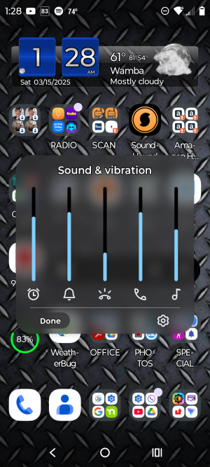

But, I learned several things. I don't remember designating my power button to bring up voice search. Corrected that and been easily get to Safe Mode. And, I can hit the volume button, then the three dots ... And see the expanded volume choices in the attachment.
