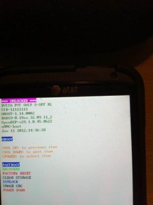

I might add , the pic is the "bootloader" screen , this is where you start with the rooting and getting started. If you will use the All in one Toolkit, it will take you there using the directions given on the link above. Without the toolkit, by powering off the device , then holding the volume down button and holding the power button at the same time, after a few seconds the 3 light buttons at the bottom will flash, when they stop, continue holding the volume down button and release the power button , another few seconds the bootloader screen will come up. You can scroll up and down the list but DO NOT PUSH the power button in other than reboot. Terrible things will result. Download the AOI toolkit and follow the directions from there starting on the left side and working to the right boxes. You must be in unlocked to flash the TWRP recovery and continue to get a rom of your choice on the phone. Viper XL has a installer used in recovery which does not need to be boot img. flashed which makes it simple to install for a noobie.
