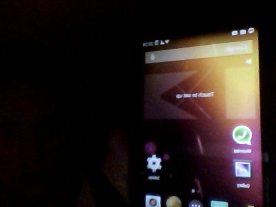

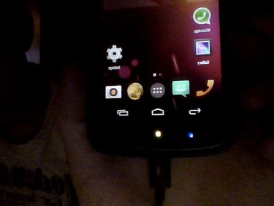

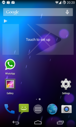

Guys i should have read your comments before installing that s****. I've installed cyanogenmod 11 succesfully. but after i installed usb otg stuff, the colors have inverted themselves, changed. Videos also won't work properly and yeah..
So is there a way to uninstall the usb otg mode, or do i have to reinstall cyanogenmod? Thanks guys!

You might as well just re-install CM; since you've only been living with it a few hours I don't imagine you have much you need to back up. Most firmware tweaks you have to flash don't have uninstall tools, and in any case why take the risk that it won't be a perfect restore when you've got nothing to lose by simply wiping?
