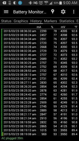

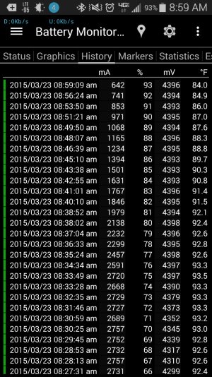

On the note 4,adaptive charging tapers off starting around 75%. Charging rate over 2a would be adaptive charging. You can use an app like battery monitor widget to log.
Note that adaptive charging isn't actually charging over 2a,that is just how it is shown.
