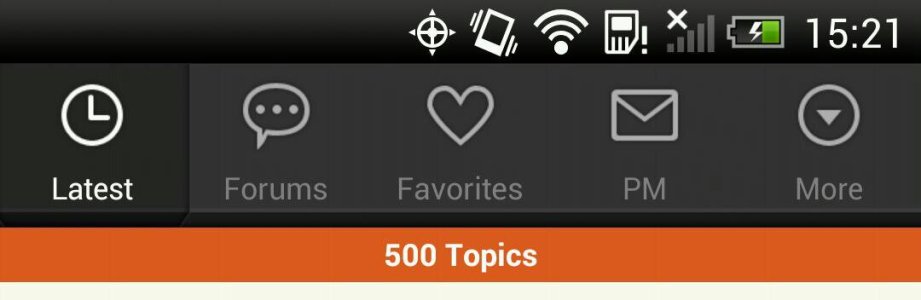

I experienced this issue again yesterday 4 times. I had my DNA replaced in January and had not seen any SIM issues since then. It is rather odd that a whole bunch of us started seeing this again in the last few days. The only way to workaround the problem was to remove/reseat the SIM card. I called Verizon and HTC is requiring them to replace the phone again with the last update pre-installed. I know that it is not going to make a difference, but the replacement phone is on its' way today. This will be my 3rd hardware replacement and I have gone through 5 SIM cards. I am going to demand that they replace this with a different model if it continues to occur.
SIM card error again. Err.
"Differences of habit and language are nothing at all if our aims are identical and our hearts are open.? -courtesy of Albus Dumbledore, via my droid DNA.
taking a pencil eraser to my sim card seems to help a bit. I got 2 weeks between failures. putting tape on the back of my sim card did nothing for me. I just took an eraser to my sim card again, yesterday.
