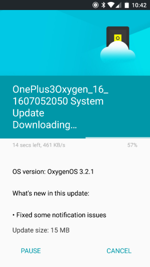

So I've read a lot of posts and articles since getting my OPT. I cannot really figure out how to get notifications - ESPN, text messages, etc. - to pop up when my phone is asleep, locked, however one describes it. It seems I get notifications when I first put the phone down for a couple of minutes, then nothing until I unlock the phone. Once I unlock they all come streaming into the status bar.
I've checked all the usual places - slider settings, app notification settings, etc. all of these are set to their default values. I thought I saw this was an issue with Doze, but this doesn't take "hours" to start happening, just a few minutes. I thought this was a bug that OxyOS 3.2.1 was going to fix but maybe I only thought I read that because I installed 3.2.1 this morning and the issue remains.

Thanks keyz. If I'm reading that correctly it looks like there is a post-3.2.1 patch that I'll need to wait for. I checked just now and according to the system update feature I'm up to date. Last thing I installed was 3.2.1 yesterday.
doa70 - the latest patch - 3.2.1 will not fix this issue. I know, as I have it installed. The problem you and many others are seeing with notifications failing is caused by Marshmallow's "doze" function. In an effort to save the battery it puts the phone in a mode where it stops communicating. OnePlus didn't implement this doze function correctly. After 8.5 minutes the phone goes into doze and never comes out. Change the settings for battery optimization and changing launchers etc in Marshmallow will not resolve this problem.
You need to do as many have, and disable the doze function. It's easy, but you need access to a PC. I haven't noticed any battery issues and I've been running it without doze enabled for 2 weeks now.
