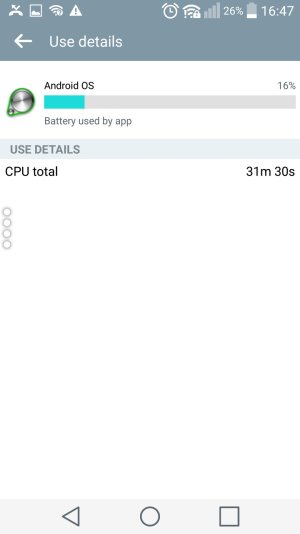

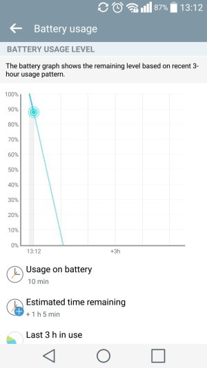

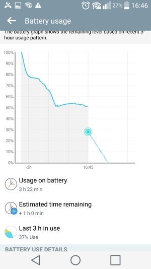

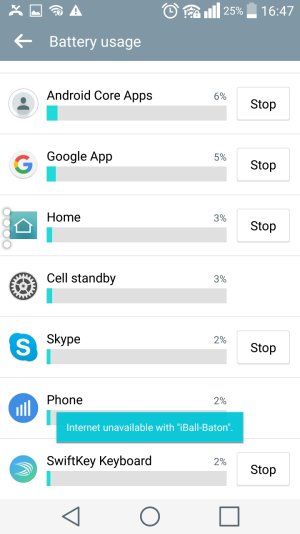

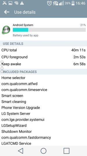

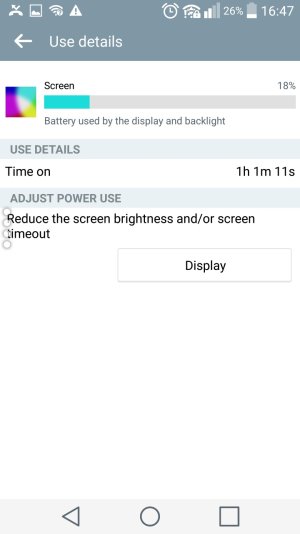

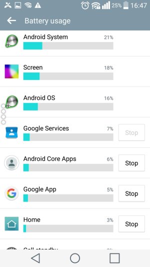

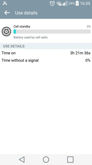

Here are the screenshots.
Battery was draining very quickly after full charge when I was using it for browsing. But that slowed down when I reduced my usage.
As you can see here when battery was at around 50%, it again went into the boot loop and suddenly the battery went down to 27%
I used the phone normally and got 2 charge cycles without the bootloop. Today once again t went into boot loop at 37%
