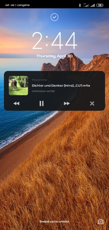

Any idea on how to attempt to fix that?
It doesn't even set it to the default oem background images, it sets two random pictures to lock and home screen.

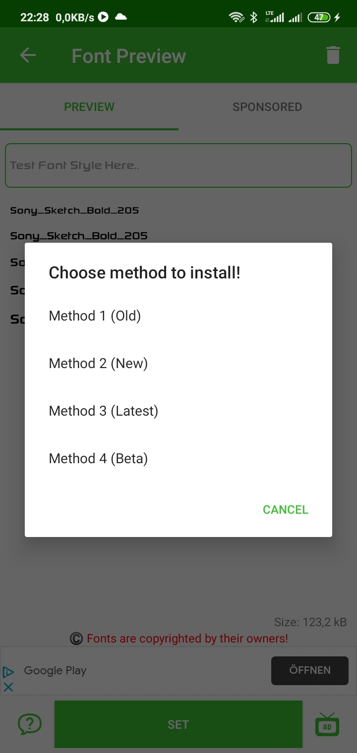

I seemed to have figured out why I have/had this bug.
Happens with the zfont app. The app offers 4 different methods for Xiaomi's MIUI's to apply new fonts, and at least one of them is causing issues
thats how they're called
I tried 'new' and the bug occurs. Reproducible. Didn't think of it first that zfont could be the issue, cause the font was installed without errors. But I had to reset my phone now twice to confirm, that zfont and the 'new' method for Xiaomi's MIUI's fail on my redmi 8a.
Not sure if I'm willing to test the others to soon. But I am sure I'll at some point. Next on the list is 'latest', followed by beta......
