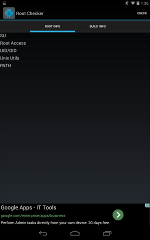

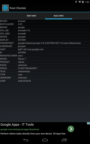

Flixter had asked me to use Root Checker to find out if it was rooted or not:

Hi, dogday007...
You should tap on the "CHECK" button at the upper right hand corner of the ROOT INFO tab of the Root Checker app you have installed. This will then give details about the root status of your device.
If you're Nexus 7 is rooted with Chainfires SuperSU app, it should be relatively straightforward to unroot.
