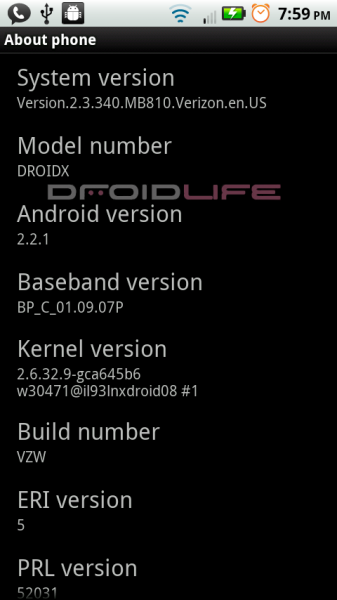

My kernel and baseband are different from the one in this photo:
For instance, my baseband in BP_C_01.09.12P
Should I not do it through RSD if that's the case?
This is because you are probably running the build that was pushed out to a few devices that is listed as the OTA version. This is the most recent version 4.5.588.MB810 and your screen shot is of the Froyo 2.2.1 build 2.3.340..

Yeah, mine matches the screen shot on the left. Will I run in to issues if I try to go back to Froyo from this version?
No you should not have any issues, all you have to do is use the official 2.2.1 (Froyo) SBF, I have restored mine a few times when the newer builds hit without any issues.
You need to use RSD and the full SBF, not the system SBF. If I recall correctly, the full SBF is about 434MB unzipped.
Read up on the SBF process and follow instructions very carefully.
