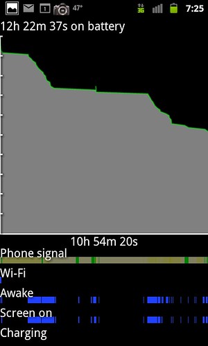

These days, most kernel devs have moved on to the .37 kernel source, as these have shown to provide the best performance and superior battery life.

A little info on the smartass governor; the smartass governor is a modified interactive governor, with a built in screen off profile. This governor is meant for the best blend of performance and battery life. All kernels except slayher's have the smartass governor included.
