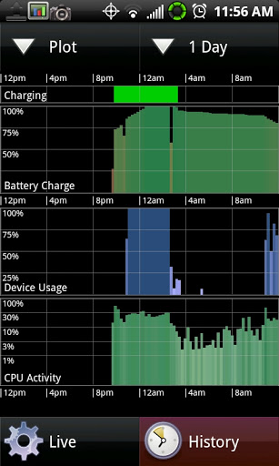

Comparison:
The only applicable parts is after the charging finishes (after the solid green bar ends)
Before Perflock Disabler:
After Perflock Disabler:
See that little dip at the end? That's when I was turning the screen on and messing with the phone for this tutorial. What a difference.

Hmmm, what does Perflock Disabler actually do? I don't understand how it can account for such a significant difference in the slope. Isn't it basically doing the same thing that the Overclock Widget does (or what it's meant to do)?
The Disabler just removes HTC's restriction on the kernel. With Perflock enabled, you could try to set your CPU to go to 245Mhz when the screen turns off, and it would SEEM to work, but it actually wouldn't do a thing. With the disabler, you can now control the speed of the CPU completely. That's why this is a big battery saver, because we are forcing the CPU to go super duper slow whenever the screen is off.

Not really sure why there is a need for this when the Snapdragon already auto justs Mhz to conserve battery? you can download tools to verify. pegging your processor at 245mhz while the screen is shut off, why not just turn your phone off if you are that concerned about battery life?
Yes, the processor does indeed auto-adjust itself. But the thing is, when your screen is off, it could still go up to 1Ghz if it detects Pandora running or if Facebook wakes up to do a sync. It happens a lot more often than you might think, and the processor is RARELY auto-adjusted to 245Mhz.
With SetCPU, you can tell the CPU to always stay at 245Mhz when the screen is off, giving you free battery life while not sacrificing anything (much)
Edit: See that 8 hour battery graph in the OP? Before, when the CPU was auto-adjusted, the battery would have gone to around 0% while it idled. Now, it's going to around 95%! Isn't that crazy
