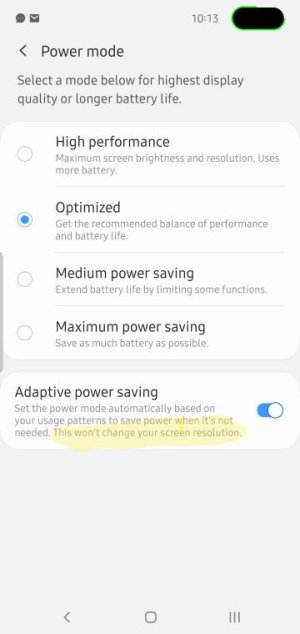

I have adaptive power saving enabled, but that specifically states it will not change screen resolution. The power mode is set to optimized, which is what I've always had it set to, but this is the first time I've had this issue.

If you set the resolution to WQHD and goes back to FHD that adaptive power saving mode will change it
Hmm, confusing because it specifically says it won't do that.View attachment 301432
I know and I've been through this , in that adaptive power saving mode after some time it will switch to medium mode then back to optimized, now to get around this I've tested is in medium power mode select your screen resolution and it wont change again , so keep in display settings WQHD and then in medium mode WQHD then it wont switch anymore
Interesting, what a terrible implementation, unless it is in fact a bug. You would think even if it does switch it to medium, the fact that it says it won't change resolution, it wouldn't change the resolution. Thanks for the tip.
It must be a bug, but dont forget medium power saves more then optimized so if you dont set the default resolution in there it should go down in resolution if that makes sense.
Your welcome!
I followed these instructions, and confirm that it works for me. No more changing of the resolution.
