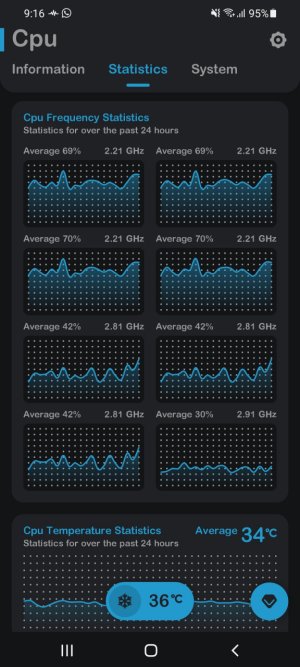

CPU Monitor keeps saying that the average temp is 33-34C for the last 24hour though.

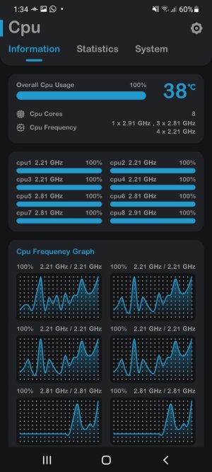

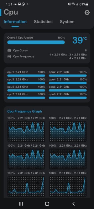

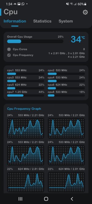

But I keep seeing spikes like this every now and then.
