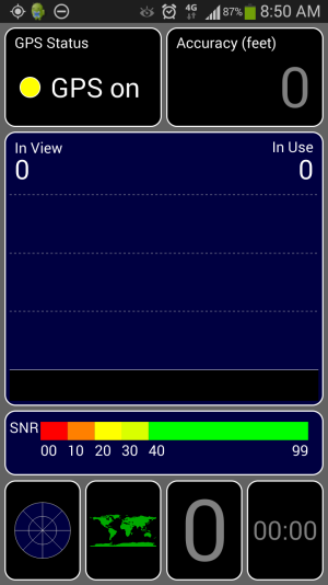

I've got a SHG-I747M with Rogers in Canada.
I searched and searched for months and have just about given up. My GPS no longer works.. It will not even see any satellites.. let alone lock onto one.
When I use that GPS status.. it does not even show any satellites that it can lock onto.
I've tried the screw tightening..
I've tried flashing to Stock Rom, Trying New ROM.. (Liquid smooth and CM) still no luck.
I've taken the phone apart and pried up the pins and cleaned the contacts.. and no luck..
It will give me an aprox location of 100-1000 Meters.. and the GPS will not guide as it does not know where the hell i am.
I was thinking to replace the antenna but my wifi seems to work no issues.. is there something else I can try before i bite the bullet and get a new phone?

I've tried that app already.. and it shows nothing found.. this screen shot was taken after more then 10 mins running.. :(
If it is a hardware problem.. other than the antenna.. what else could it be?
I'm not sure flashing the baseband will do anything as everything else works flawlessly with the phone..
