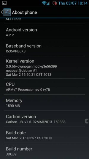

It sounds to me like your phone is already rooted - can you post a screenshot of your About page?
As you can see from mineuploadfromtaptalk1362720136033.jpgI have a different ROM loaded, and something like that (or even if your phone is just rooted with an alternate recovery loaded) would prevent you from loading the current update.
