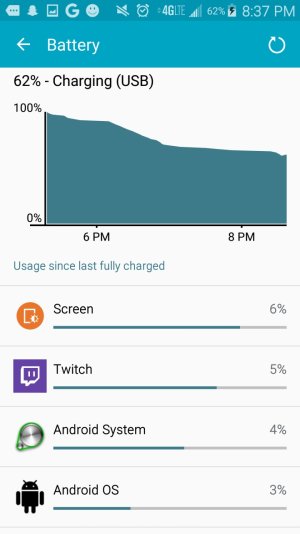

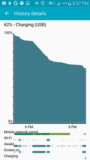

I tested this out and here are the results:
I've been at home this whole time and it's only been on data so the signal shouldn't have changed much.
It'd help to see the stats after you've gone from 100% down to 20-30% (not down by 20-30%), just so that we get a good idea of the battery usage over the span of an entire battery charge.
In addition, it would help to see the total screen-on time.

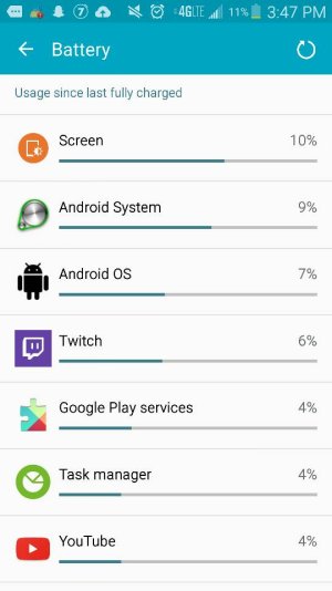

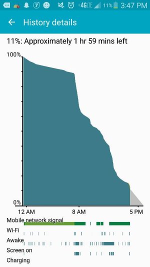

Here's a full one
Ok, but the other menu screens would also be helpful as previously recommended, since we want to see what individual battery usage by apps has been during this period, as well as total screen on time.
Is this the other screen that mentioned because I don't see any other options:

Tap the Screen entry in that menu to get the details, including the total Screen On Time.
