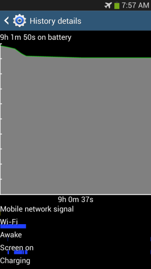

BTW my S4 Mini used to be a battery hog too, sucking down 25 to 30% overnight while in airplane mode with wifi, location services, and everything else I could find turn'd off. After months of detective work, finding settings buried in things like PlayStore, the camera, and Gmail, and changing the settings to be battery (and resource) friendly, I now see only a 2% drop over an 8 hour period with no use. And that's on a downsized battery. I first step'd down from the stock 1900 mAh to the 1500 for S3 Mini, after which some poster on AC call'd me "just weird!" So I haven't (previously) mention'd here about having downsized even further. I'm now using an 1140 mAh battery, making my S4 Mini possibly the lightest weight Android device on the planet, at ~3.5 oz.
Screenshot below is from a couple mornings ago. An hour before going to bed, I pull'd the S4 Mini off her multi-media cradel where she got fully charged while playing music over the living room stereo system. And then I did about an hour's worth of file updating for a Web site I maintain at Google Drive, running the battery down to 91%. Upon waking up the next morning, battery was still at 90%, dropping to 89% shortly after taking the screenshot. Hopefully, this gives you reason to continue with efforts on your wife's S4 Mini.
