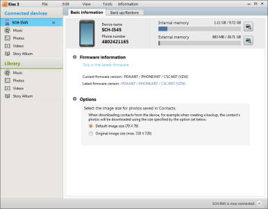

I downloaded the 4.3 firmware and used odin to do a full wipe and reflash the phone, let it sit for over an hour and a half (went to the gym), stayed on the entire time under its own power. Popped my SIM back in and now reloading my software, I'll report back how it does shortly.
FYI if you want a link to the firmware, this URL has it:
DroidViews | How to Unbrick Your Bricked Samsung Galaxy S4 GT-I9500, GT-I9505, SCH-I545
or
DroidViews | How to Install Latest Official/Stock Firmware on Samsung Galaxy S4 (All Models)
4.3 (wipes data, what I did): SCH-I545_VZW_1_20131023084910_v4vth34m5z_fac.zip | by Open1Your1Eyes0 for Galaxy S4
4.3 (does not wipe data, can't confirm): http://invisiblek.org/joder/SCH-I545_VZW_1_20131023084910_4t7oj0w5gv.zip
Verified with Samsung Kies3 that its running latest and greatest firmware
