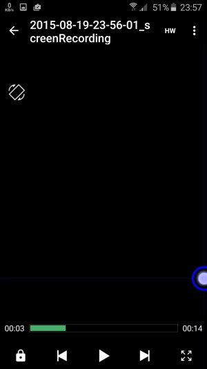

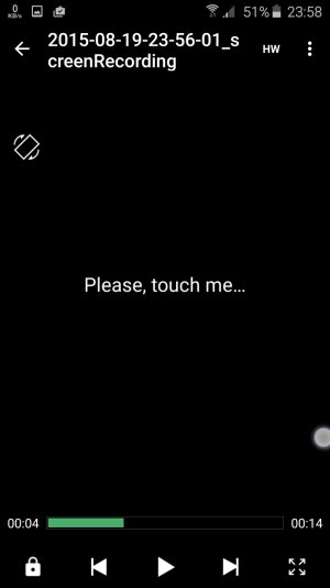

And then got another info. Sometimes the touch is registred by the system (white dot) but doesn't reach the application (no blue circle) so I though maybe that's why sometimes SwiftKey doesn't register my input on the right side characters
So it must be on some software layer that this bug is ocurring
Screenshot 1: correct behaviour, the touch is registered by the system and passed to the application
Screenshot 2: incorrect behaviour, the touch is registered by the system but NOT passed to the application

Thank you fo your reply. On safe mode, it's always responding correctly. I had to uninstall the MobileGo app because it had a quick toggle panel with the handle located on the bottom right then did some tests with the panel enabled/disabled and figured out that it was causing the whole problem. So thanks a lot for the useful hint!
