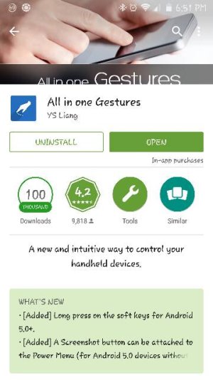

I downloaded the All in One Gesture app in play store and made my back button go to recent apps with a long press and that fixed it for me. I tried to make the actual recent apps button work with the app but it didn't. They must have disabled the button all together.
