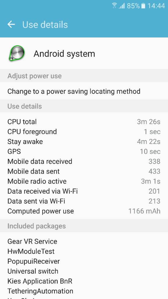

I have gsam and have no idea what is causing me to lose battery. My phone reads 35% for Android OS and the highest cause of my battery. I wish I could figure out what was causing it
