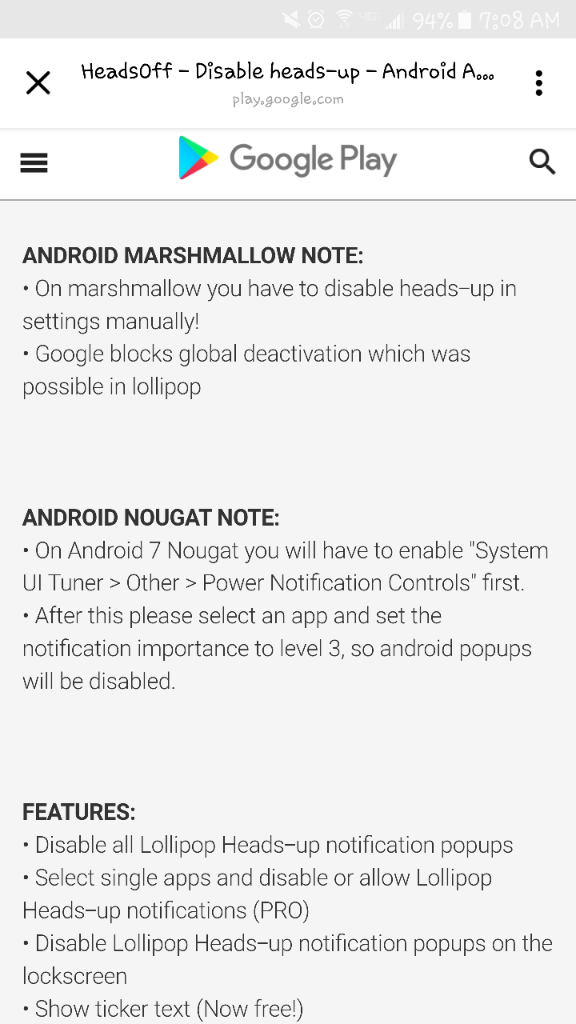

I was looking at the headsoff description, and there is a nougat note as you see below. Have you tried that, does it work after doing that?

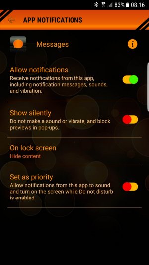

Yes on lock screen you can but not on home screen which is what I need, my phones normally on my holder in the car so I can listen to my music but every message now pops up showing everyone in my car my messages, very annoying
