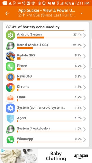

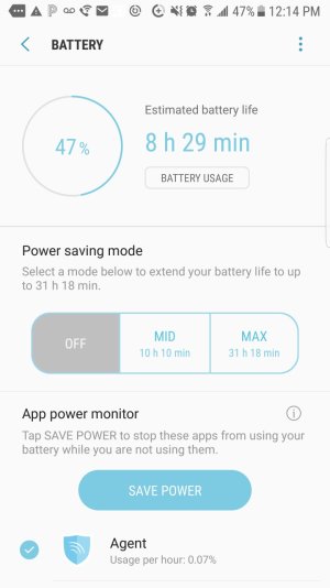

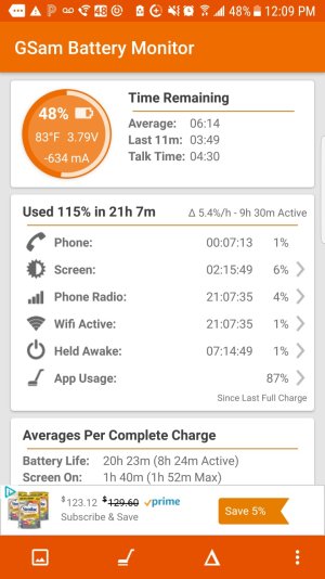

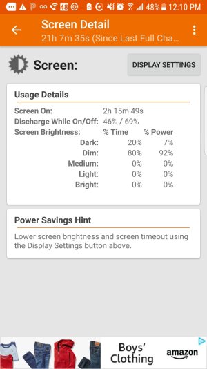

Attaching screenshots here. I didn't find #4 on your list though.
Also including 3 additional screenshots which seem relevant since the OS is showing as the major battery consumer.

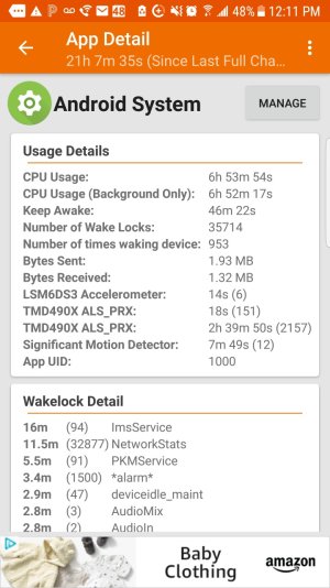

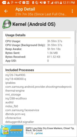

Hmm, nothing jumps out at me in those screenshots, except the fact that apps in general are using a big portion of battery. But no app in particular stands out, except for System and Kernel.
You cell signal indicator in the screenshots looks good, but it would still be good to see the Cell Signal Strength graph in GSam, just to rule that out completely. If it spends a lot of time in medium to low, that can contribute.

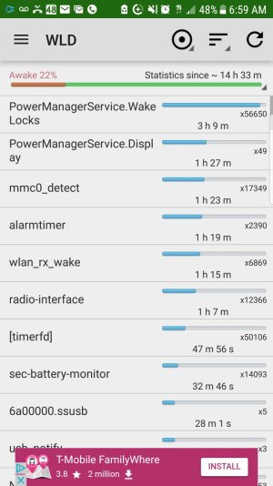

No neither of them show that - I looked at the signal strength graph and that's mostly high. I'm going to install Wakelock Detector Lite. That might show the apps keeping it awake.

Installed WLD and this is the most useful screenshot (I think) of the lot but unfortunately it doesn't tell much. From what I've seen online, this is just the cumulative wakelocks and there is no way to drill deeper in this app.
I see there is paid app which can do that but not sure if worth it.
I deleted the cache; perhaps that will fix it
