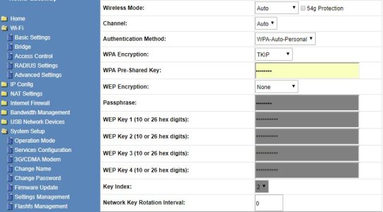

I would also like to share what worked for me.
Initially Samsung S7 Edge wouldn't connect to Wi-Fi via D-link DIR-320 router: it detected the network, but made no attempts to connect, or when forced to connect manually, nothing happened. A dozen other devices in the household were working with this router seamelessly.
Updating firmware to the latest official version, or using alternative versions DID NOT work.
After experimenting with settings a bit, I discovered that these ones worked!
Particularly, changing WPA2 to WPA-Auto-Personal, and TKIP + AES to TKIP.
Hope this saves someone the hours I spent in frustration, Google, and trial & error :)
