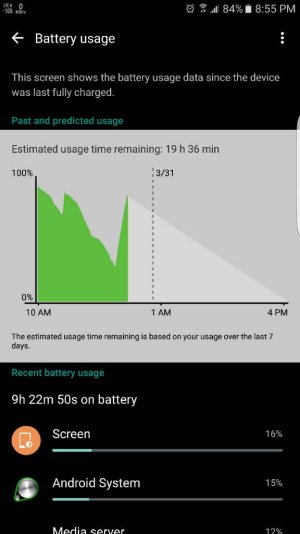

Obviously cord is still the fastest but I do notice a difference with fast wireless vs non even if it's not insanely drastic.
