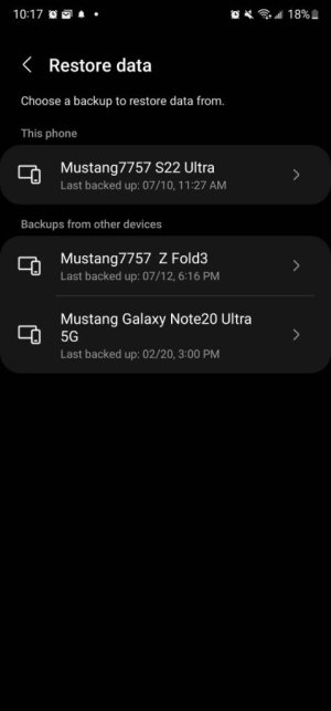

Yeah as long as long there the same account , see in settings>account and back up on my s22U I go to restore I have 3 devices that uses same account to restore
