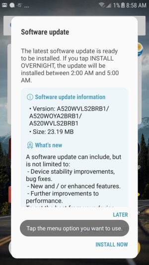

Ok, I will do that. In the meantime, an update for my phone has been released. Funny thing is, maybe it would fix my current issue, however I can't even install it because it keeps saying that it needs at least 20% battery. Since my battery is constantly stuck at 1%, the installation cannot be performed.
Check attached image.

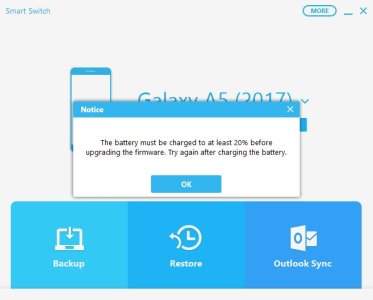

I downloaded Smart Switch, installed it and backed up the data in order to do the firmware upgrade. Problem is, I cannot continue with the update since the battery is stuck at 1%, even though I had left the phone on charge the entire day before trying to update it.
Please check the image below

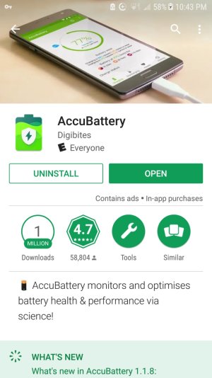

Screenshot_20180418-224309.jpg This is a free app & if you actually follow what this guy has surmised for a month, may find that you actually get more battery. I drive truck for about 14-16 work hours & charge maybe 1-2 a day myself after giving this a try for just under a month & still going
