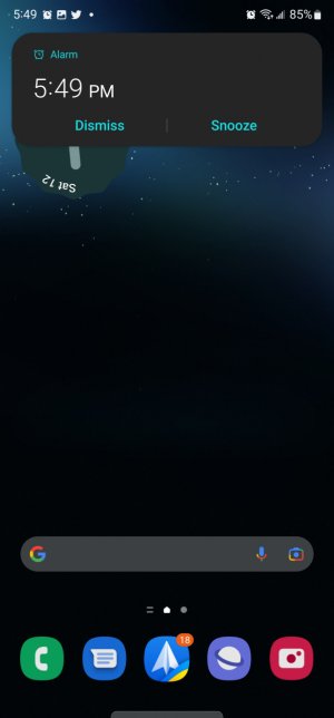

I get this with screen on from Google Clock. Pill shaped alert at top of screen. Just stays on for a few seconds though. The second one is Samsung Clock with notification that stays on much longer.

Yes that IS the problem!
On my Note 9 I got a full sized alert instead of that little one
I have to use Google Clock because Samsung Clock does not send notifications to my wear os watch. When I am wearing the watch I shut off google clock alarms from watch but when watching TV with phone in hand it is a pita to only have that tiny alert for a second. The noise continues but no easy way to shut it off.
Strangley, two taps from AOD gives the full sized alert from Google Clock that I want!

I did find I could get a box instead of a pill if I shut off "short notifications" under edge alerts (you know when the entire periphery of the edge lights up with a notification)
To get edge to light up you must turn on brief alert instead of long alert but brief alert causes the AOD and Homescreen issues.
So I have solved it... sort of but I have to shut off edge alert for the clock. I would prefer not to.
