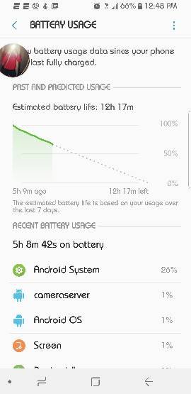

Same thing happened to me yesterday. But it was Android system
