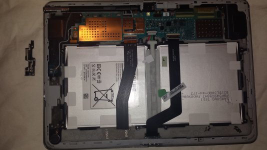

20140918_162546.jpgSo I had the horrible black screen of brick after dropping this thing all of two feet onto carpet. Just before I threw it in the trash I saw a post that saved the day. Well I had to take the rear panel off to do the two minute fix and was ecstatic. Now the problem is that I can't get it back on properly and there is not any videos on the 2014 around yet.
The issue is a one inch, long plastic piece that is on the same side as the stylus. It is the only loose piece inside the rear case. I have tried every single angle and configuration but it always feels like I am going to break something if I try to close it all the way.
I am guessing that the piece has something to do with the WiFi because my range has been drastically reduced since the fix.
