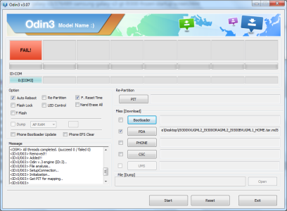

Tried the above, as suggested, using Odin but had the following message returned. Also attached an screen print of exactly what status Odin was at at the point of failure.
<ID:0/003> Added!!
<ID:0/003> Odin v.3 engine (ID:3)..
<ID:0/003> File analysis..
<ID:0/003> SetupConnection..
<ID:0/003> Initialzation..
<ID:0/003> Get PIT for mapping..
<ID:0/003>
<ID:0/003> There is no PIT partition.
<OSM> All threads completed. (succeed 0 / failed 1)
Not sure what to do next - PIT??? I'm lost now!!
Dang it - you're the second person today with that same error. Here's my reply from the other thread.
There is a way to try to write just the pit partition (using Odin) but I don't know enough about that to get you started, other than to suggest that you try over on XDA (or Google it - I don't know if the pit file is specific to a carrier or the chipset or memory size, so I'm not sure where you'd get it).
