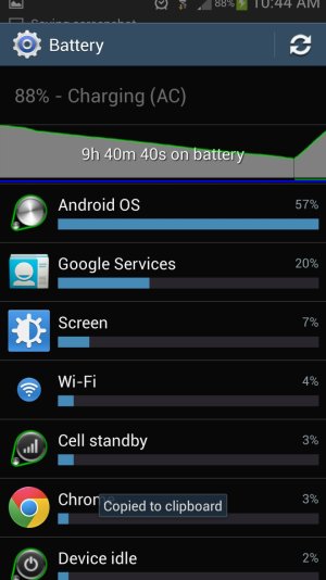

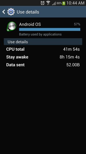

My s4 has suddenly started draining a lot of battery lately. In the battery usage section it shows the main culprit is android OS that drinks up 57% of the battery life. Out of the 9(around) hours it has been discharging, 8 hours 15 minutes it remains awake and the rest it sleeps.
That is high for the OS, I notice that right beneath it is Google Services. Are you by chance using Google+ or Hangouts? If so, you may want to try disabling those, temporarily, and see if it has any impact.

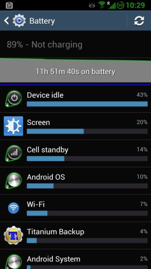

Here's mine overnight. You need to check what keeps your device awake, it's not normal at all. Get BBS or Wakelock Detector and scan your device for malware/viruses.

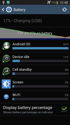

I am having a similar problem but only in the last few days...82/83% Androis os usage. I even put it in flight mode...dropped 1% :S I have tried rebooting still the same
