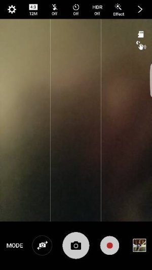

Hello,
I can't record video with the phone. The video record button is grayed out. The option for Motion Photo works though, which records a short video clip before a picture is taken. I'm not using an SD Card, so I checked how much internal storage I was using. I still have 15.70 GB available. Any help!?

Can you provide a summary of everything you've tried so far? Also screenshots of the relevant screens may be helpful.
